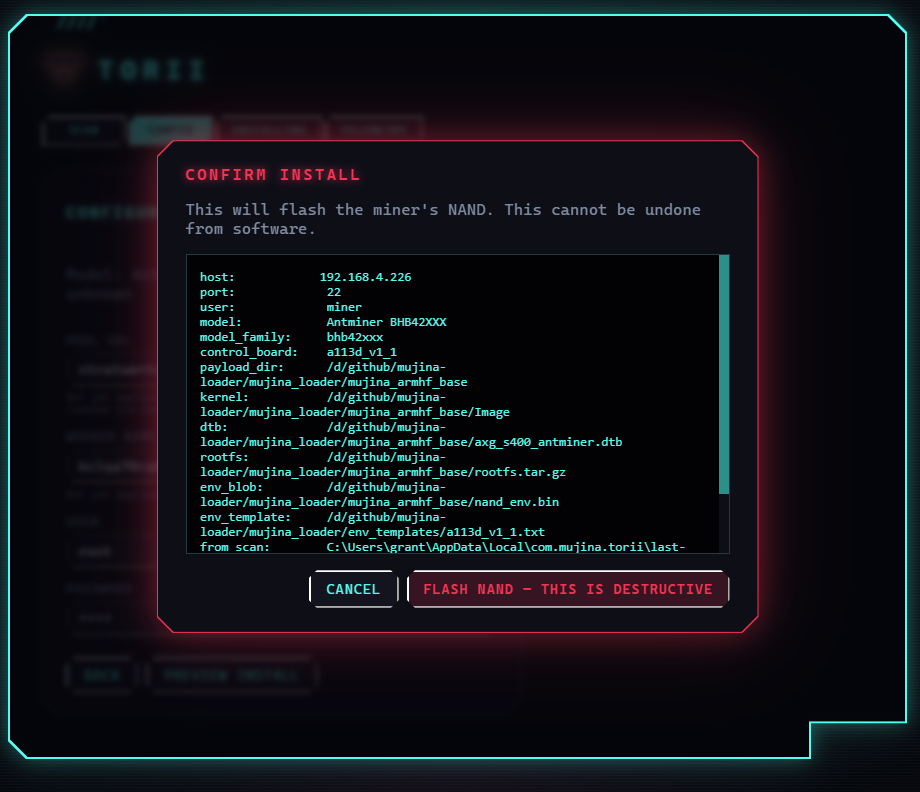

I am trying a bare-bones loader app from bitmain fw to see if i can start with the jpro and then other miners…we’’ll see if it works:
