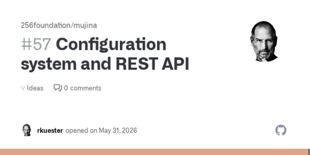

Quick follow-up: one of my action items was to write up my vision of the config design specifics so weâd have something concrete to review instead of hashing it out in the abstract.
Thatâs done. It grew into a full set of requirements for Mujinaâs configuration system and REST API, written up as MIP-0001 (the first Mujina Improvement Proposal, a new lightweight design-doc convention in the spirit of Bitcoinâs BIPs and Nostrâs NIPs).
Thereâs a short intro thread on GitHub Discussions:
And the MIP itself is open as a pull request, which is where review and comments should happen:
Iâd really value everyoneâs feedback! Please read it and poke holes; comments, suggestions, and patches welcome on the PR.
