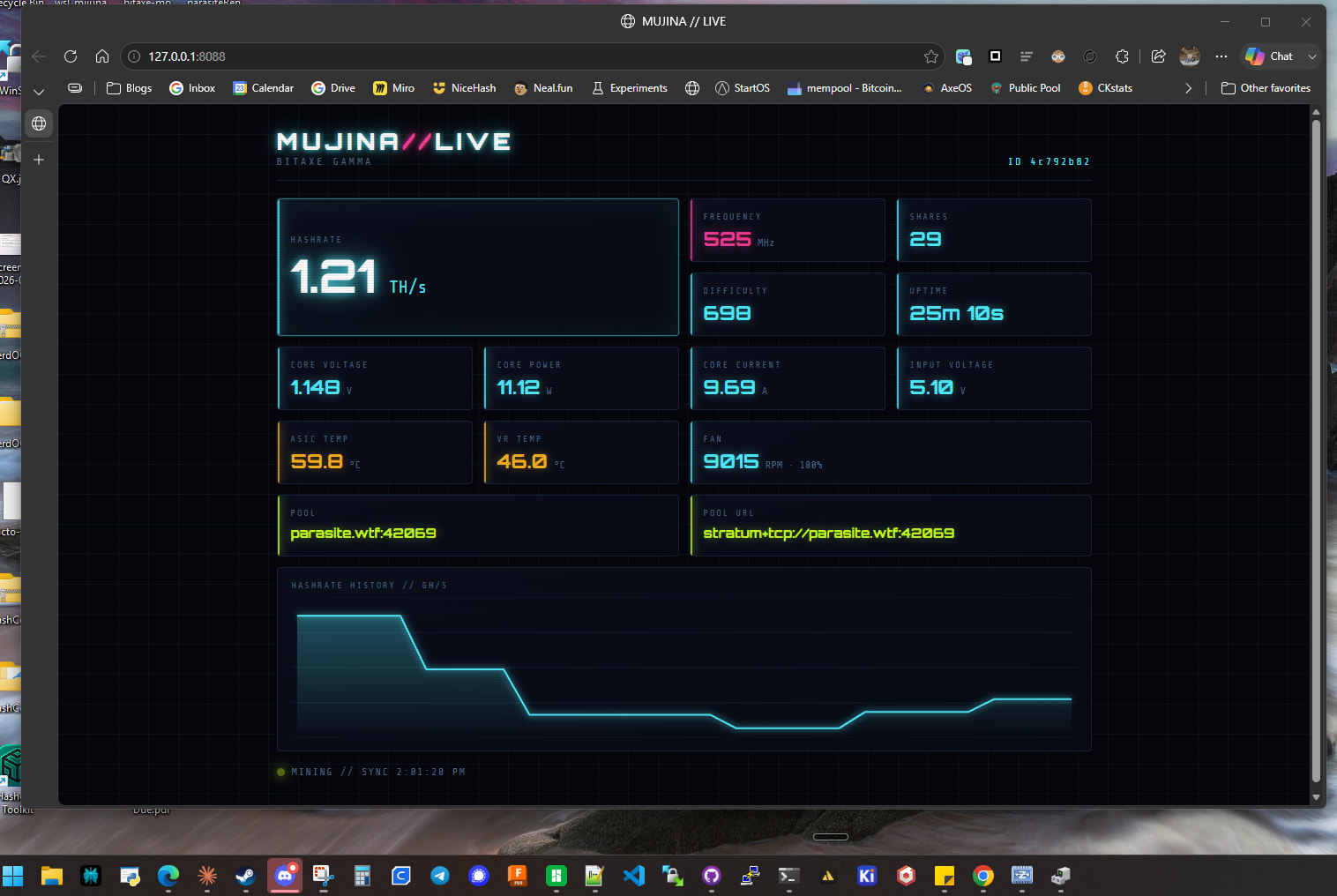

That helped, but I still need to make some code changes and some other fixes on the USB side. I was able to finally get it working here on Windows with the help of Claude. Here’s the dashboard I have running for it.I’ll be making a PR soon on to the main repo and get this thing loaded in, and I can show you what I’ve done.
